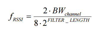

Pro ty, které to zajímá zde je popis získávání RSSI hodnoty v RF čipech Texas Instruments CC2500 používaný u některých přijímačů Frsky.
Zdroj: viz tento odkaz (viz str. 34 a 35)
Kdo se tím chce zabývat podrobněji nechť položí své dotazy ohledně podrobností i případné přesnosti ve vztahu k získávání RSSI hodnoty u RF čipu CC2500 přes kontaktní formulář technické podpory Texas Instruments Semiconductor viz tento odkaz.
17.3 RSSI
The RSSI value is an estimate of the signal level in the chosen channel. This value is based on the current gain setting in the RX chain and the measured signal level in the channel.
In RX mode, the RSSI value can be read continuously from the RSSI status register until the demodulator detects a sync word (when sync word detection is enabled). At that point the RSSI readout value is frozen until the next time the chip enters the RX state. The RSSI value is in dBm with ½dB resolution. The RSSI update rate, fRSSI, depends on the receiver filter bandwidth (BWchannel defined in Section 13) and AGCCTRL0.FILTER_LENGTH.FILTER LENGTH
If PKTCTRL1.APPEND_STATUS is enabled the RSSI value at sync word detection is automatically added to the first byte appended after the data payload.
The RSSI value read from the RSSI status register is a 2’s complement number. The following procedure can be used to convert the RSSI reading to an absolute power level (RSSI_dBm).
1) Read the RSSI status register
2) Convert the reading from a hexadecimal number to a decimal number (RSSI_dec)
3) If RSSI_dec ≥ 128 then RSSI_dBm = (RSSI_dec - 256)/2 – RSSI_offset
4) Else if RSSI_dec < 128 then RSSI_dBm = (RSSI_dec)/2 – RSSI_offset
Table 25 provides typical values for the RSSI_offset.
Figure 13 shows typical plots of RSSI readings as a function of input power level for different data rates
