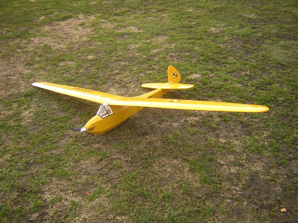

Re: MÍRA 3 - 1924
Excellent work, I admire it. But for my flying I prefer models I don´t worry to destroy them. Retroplane rules don´t like an engine in the nose and Oracover !
