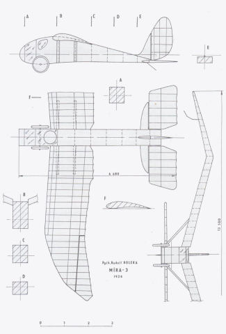

Hi everyone, my name is Vincent, I'm a french modeller, webmaster of the website Retroplane. I love the glider MÍRA 3 and maybe I would like to build it. Is it by any chance someone would have pictures of the glider Czech MÍRA 3? I have already the three views and a picture from the book "Bezmotorova letadla v Ceskoslovensku" but I don't find other pics/documents on the web :(
thank you if someone can help me to find other photos

Hi everyone
With your help, I was able to start building the MIRA3
The scale is 1/4.5
master for side of fuselage
2 sides of fuselage
with the wheels
and the rudder with quick removable system
all details on my website http://www.retroplane.net/mira3/page1.htm
next step, the stabilizer...
